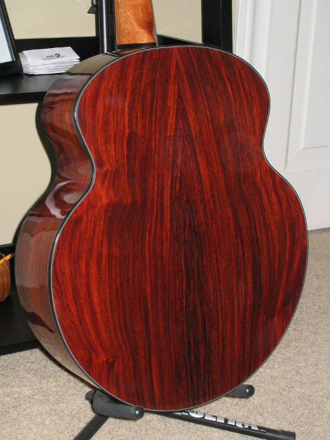

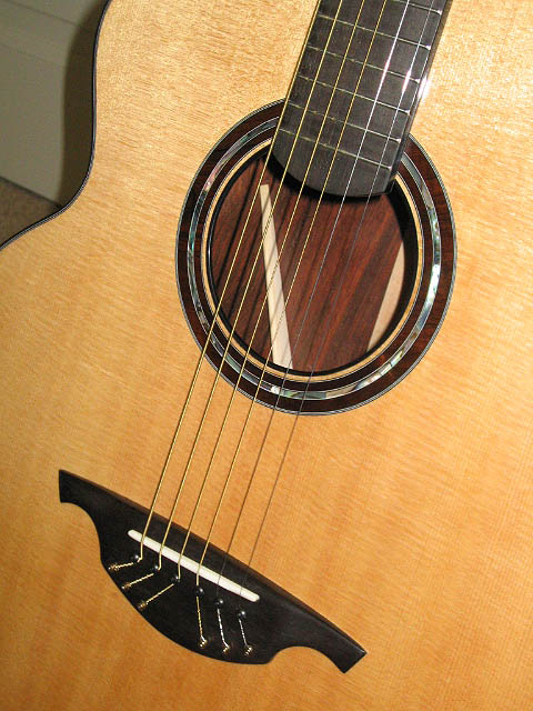

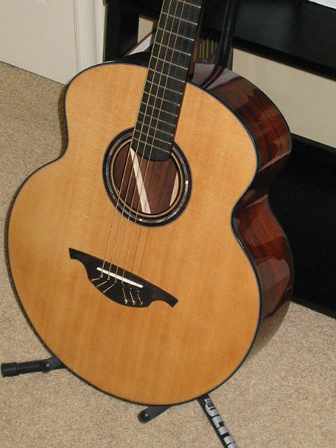

Here's some shots of the second of the three I'm taking to the big show. It's cocobolo/sitka and ebony bound. Still lacks a clear pickguard and some more buffing (I'll be buffing them until I pack them for shipping, I can't help myself). Thanks for looking.

Very nice Jimmy, I don't want you parking next me down there either
Don't rub all the finish off.

Stunning top silking Jimmy and the back ain't too shabby either
Tell us more about the bridge design and it's benefits [besides being cool looking]. I have seen something similar on Babicz guitars.

[QUOTE=Tim McKnight] Stunning top silking Jimmy and the back ain't too shabby either
Tell us more about the bridge design and it's benefits [besides being cool looking]. I have seen something similar on Babicz guitars.[/QUOTE]
Tim, the bridge on this guitar is my take on Steve Klein's design. I ran through about a dozen prototypes before I was happy with it, but I think it was worth the effort. Advantages? After you get used to it, string changes are very quick and you won't have to worry about what kind of bridge pins look best. I can't say that it has any tonal effect, but I do think it sets the guitar apart visually. This may not be a good thing in some peoples eyes, though. Tradition has a heavy impact on some players opinions of what a guitar should look like. For that reason I also offer a traditional pinned bridge. I'm bringing guitars with both kinds to Healdsburg and will be interested in the feedback from the folks there.
As for Jeff Babicz's design, I actually got to see his prototype at Tom Ribbecke's shop a couple of years ago. His design is quite a bit different (it's actually two pieces) and the ball ends of the strings actually attach at the perimeter of the lower bout. Very unique.

Jimmy--really sweet. I'll second Tim's comment about that top. Wow! Where did you get that? I wouldn't mind a truck load of that wood!

Another great one Jimmy. I really like the bridge on this one (as in, mind if I copy you if I give you credit).

Awesome looking guitar, can definetly see the Steve Klein influence. Is it Kasha braced?

Beautiful wood (top and back) and nice rosette. Over all a very nice looking guitar. How does it sound?
It looks like you x braced the back. What advantages do you find by doing this?

For those who asked about the top, I picked it up from LMI at the last HGF. It makes a difference when you can sift through a stack of 50 or so tops and take the stuff you want. I bought the cocobolo at the same time.
As for the bracing, it is Kasha braced. It's the third one I've done and like anything else, the more you do, the more you learn. Maybe after I build another 50 or so, I'll get the hang of it. My gut feeling is that there is a very small market for anything that's "outside the box", so I'm bringing an X-braced grand concert also. Maybe I'll be surprised, I hope so.

I'll add to the praise: The workmanship looks excellent, and it is obvious that you spent some time to find a top with massive silk and no runout. When that Sitka opens up, I'll bet this baby will sing!
Interesting take on the neck heel - it looks shorter and wider than "typical." Buckminster Fuller would appreciate the triangular cross section - it looks very strong. Is that neck heel design new, or have you done these for a while? (I can see where it would be advantageous in material usage, requiring a smaller chunk of lumber. If laminated, it looks like it could come out of a flatsawn board 6" wide.)
I'd love to see some internal bracing shots, including the back braces.
I suspect that you are right about encountering some resistance to non-X braced, non-pinned bridges, and other non-copies of traditional Martin design issues. But, this also makes your designs stand out in a sea of Martin copies. If your instruments sound great and play well, you'll do just fine!
